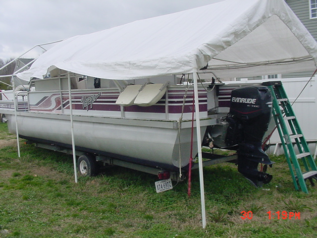

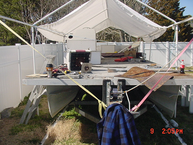

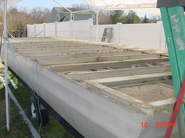

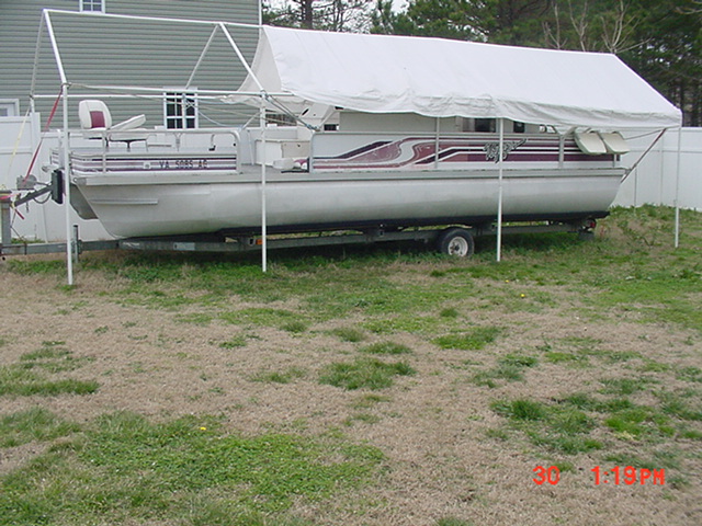

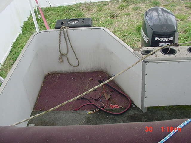

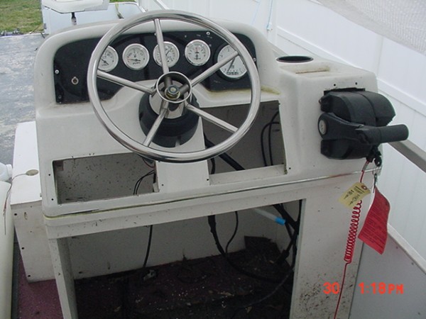

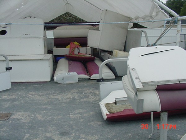

Just a few pictures of my Voyage rebuild. I got a good deal on the pontoon & my son & I have decided to do a rebuild & turn it into a fishing boat to be used for fishing ONLY. Planning on using 4 fishing chairs, center console with "T" top & rocket launchers, aerated live well & Minn-Kota trolling motor. Power will be a 2006 Evinrude E-Tech 90 engine. We will under skin it, replace the deck & are "thinking" about going with a vinyl deck covering. Nothing fancy just a simple enjoyable dependable fun filled fishing boat. Everything will be new as far as all the electrical wiring, gauges, lights, decking & deck covering . I"m reusing a center console I built for another pontoon I have that I switched out & we are looking for possibly a good used "T" top. I'll also use my 597ci HD DI Hummingbird fish finder to locate the world's largest large mouth bass. :eviltaunt lol
Hope the pics turn out as this is my first time trying to post pics on the forum. I will post more picks as I go along. The weather here is COLD :x & they are predicting SNOW in my area so not sure when I can get back outside to work on it.

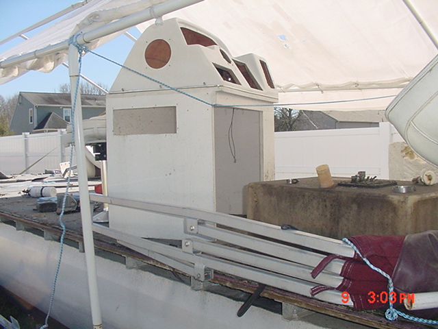

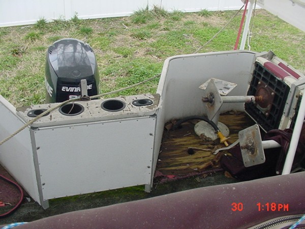

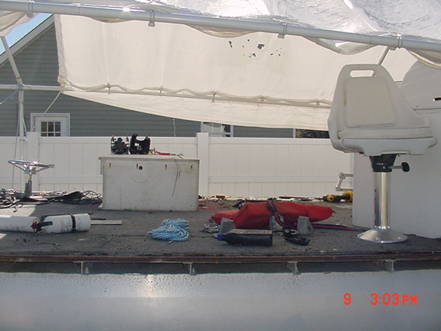

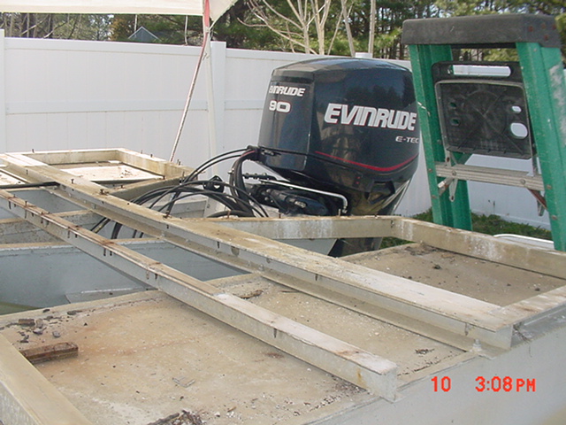

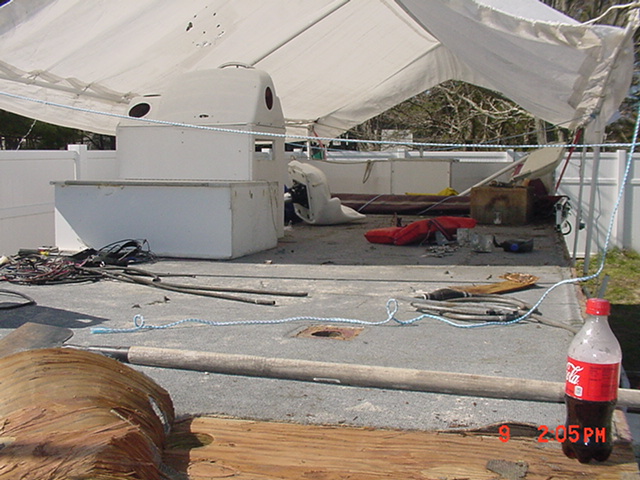

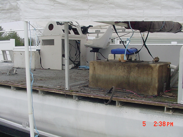

Here's a couple more pics I took before the rain started of what we got done so far. The gas tank will be mounted in the stern on the left side inside the horseshoe with a hinged cover going all across the stern to the right side that will have some cup holders & rod holders mounted in it. Planning on putting the aerated live well right in front of the engine so I don't draw water very far plus it would make for a short discharge of the live well. The live well will have a light inside for night fishing. Planning on having lights mounted on the "T" top as well as on the bow & stern for night fishing. Removing the bimini top as my son thinks it will just be in the way for fishing so the boat overall will be much lighter in total weight. I bought the trailer separate & installed new bearings, grease seals, hubs & bearing buddies as well as replaced the tires to low profile 8-ply tires load range "E". Also installed a new winch as the old strap was frayed in several places.

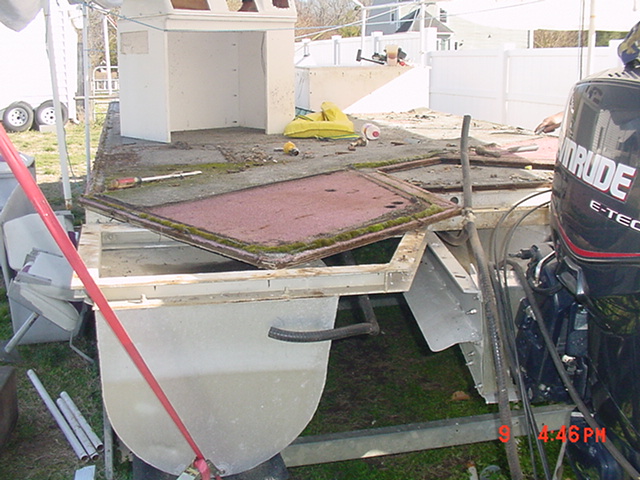

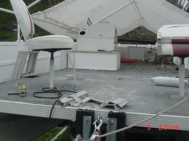

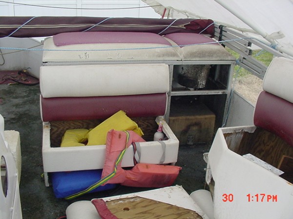

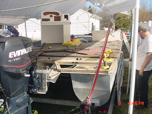

Just a short update. The weather here yesterday was BEAUTIFUL so my son & I got a LOT of tearing down done. Got the steering cable, engine control cables, engine electrical harness plus all the old wiring & the plumbing for the existing live well removed. Started tearing off the deck & was concerned as the deck screws where rusty as could be. I decided to us my sawzall to cut them & lift the plywood off & while I was getting the saw ready my son used an 18" Craftsman screwdriver & pryed up on one edge & discovered the the entire plywood deck was really just "laying" on the cross members. The wood was far more rotten then I suspected it was & water soaked really bad. Some had "glued" automotive carpet on top of the original factory carpet. I first tried to scrap the old carpet up with a large flooring scraper & it was tearing of the top layer of plywood. So we cut the carpet at the plywood joints & pryed it up with the screwdriver & got 2 sections removed. Will go back at it today or Monday & finish clearing everything off & hauling it to the junk yard. Hopefully if the weather holds up I can acid wash the entire frame & logs with pink coil cleaner & get ready to re-install the new wiring harness & get the deck ready to put down & sealed. Got a few pics of the tear down below.
