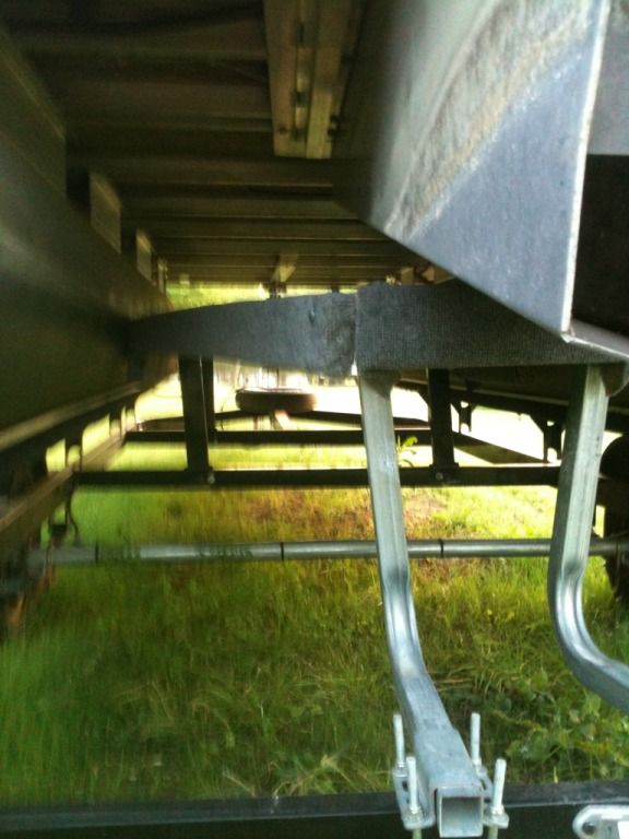

Just another way to go is to have a metal shop bend you a few pieces of metal and add 2x4s for your bunks. If I get to get the boat out this weekend I will take some better pics of mine. Been using bunks like this for over 40 years it one way or another hard to beat.

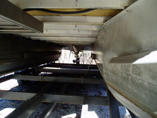

My u-bolts were too short for my trailer. I bought 2, 1/4" thick 1 1/2" wide by 12" long bands of steel at Ace and cut and drilled them to be able to drop 8, 7" long 1/2" bolts through, instead of using u-bolts.
- guides%20004.jpg (103.3 KiB) Viewed 2537 times

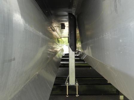

Their many types of gides around I have found this type to be the best.
- trailer back.JPG (232.56 KiB) Viewed 2427 times

I like these the best that I have seen. Thinking about getting some like this made, just wondering if there is reason you dont have these mounted more to the back?MH Hawker wrote:Theirt many types of gides around I have found this type to be the best.

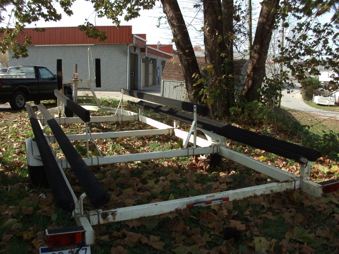

That part is under water and normally to deep to be of any real use. And this drawing may be of some help and the dementions may varie due to different toon OD`s but its a example.
- brace jpg.jpg (34.47 KiB) Viewed 2226 times

How close to the tubes should the guides be ? I don't think they should be touching nor a foot away, so how do you have yours mounted ??? This question is for anyone who has guides. Thanks,

I have it where my tube's have about a 1/2 inch clearance.Capt Sully wrote:How close to the tubes should the guides be ? I don't think they should be touching nor a foot away, so how do you have yours mounted ??? This question is for anyone who has guides. Thanks,
My V shaped guides direct them to that spot everytime.
