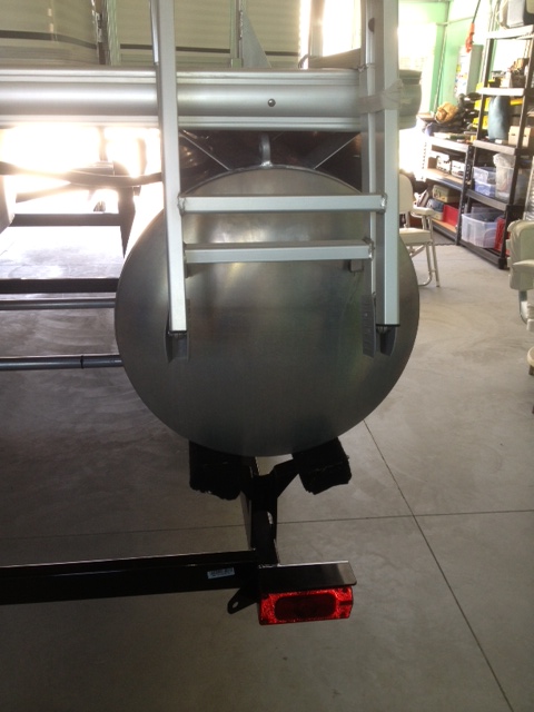

Hello Ladies and Gents--
I was wondering.... how many of you use stern tie downs on your toons?
My toon, as I'm sure most do, has a heavy tab/ring welded at the top stern of each pontoon. My trailer also has a welded tab with a hole to attach a tie down.
I would like to use tie downs at stern (previous owner did not) on both pontoons, but the port pontoon has a bracket welded at bottom of pontoon to attach live well pump and transducer. It is basically in the way and blocks the path of my proposed tie down. Starboard toon appears to have a clear path between the two rings/tabs, other than the strap rubbing against rear part of toon (see pics).
Any of have this dilemma and how did you solve?
Pics of your stern tie downs would be great!!

I'll strap mine down if I'm going to be traveling some distance, like the 45 miles to the boat shop in Havasu, or if I'm gonna launch up there on the lake.
But if I'm just going down to the local ramp, 8 miles, I don't bother.
Your set-up is exactly like mine. I just put the strap along the outboard side of the transducer mount, with a chunk of split garden hose on the sharp edge to prevent it wearing the strap.

Mine is strapped down all the time when its on the trailer. I have seen way too many boats bust bow straps and end up being off the trailer in the road, usually facing up hill. I won't take a chance. Too much $$$ invested to not put on a pair of $25.00 straps. Try going through the mount and around the trailer, if you can't get it on the trailer's strap tab.

Mine is like yours and cut my strap. I took 2 new SS bow eyes and mounted them on each side of the transom and hook there to trailer. No more problems. Where we live the roads suck, lots of potholes and just rough concrete and blacktop so I also tie bow from eyes on tip of nose cone to trailer on each side. Between the four straps and bow winch strap plus safety bow chain it ain't going nowhere. I will get pics tomorrow

I ALWAYS use tie downs. I'd like to have those fancy trailer mounted ones, but I just use regular ratchet tie downs. I do use (this is important if you polish your toons) the padded seat belt shoulder harness protectors that Velcro over the belt keep the belt from rubbing on you shoulder in back of the ratchet, fold up the tail of the tie down and Velcro it shut. That way the ratchet isn't rubbing on the toon and the extra strap isn't a hassle to tie you and out of the way. Nice and clean
