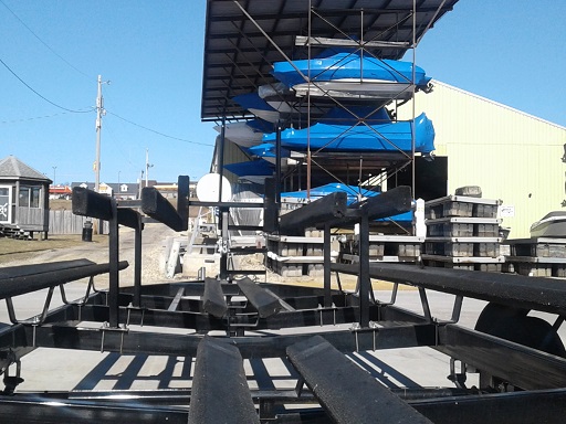

I used 2 pairs of those on my Premiers trailers. Worked good, except for in real strong side currents. The boat would want to get caught between them. So I took an afternoon last spring and welded these up in my boatshop for the Manitou trailer I bought. I used 1/4" by 4 for the base where the U bolts fit to the trailer. 1/4 X 2" L stock for the risers, 1/4X 1 1/2" for the inside guides extensions. I had about 50 bucks into everything. Most costly was the carpet. They work in the strongest currents and winds. And kept the boat real steady all the way up to the cradle.

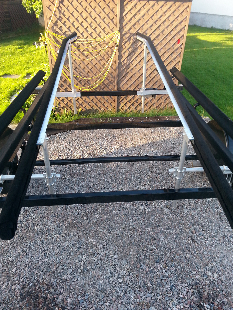

https://4c-innovations.com/
I bought and installed the guides from these people. I really like them.
Not the cheapest but really do help with cross winds.
Picture on their website of a trailer for tritoon is mine.

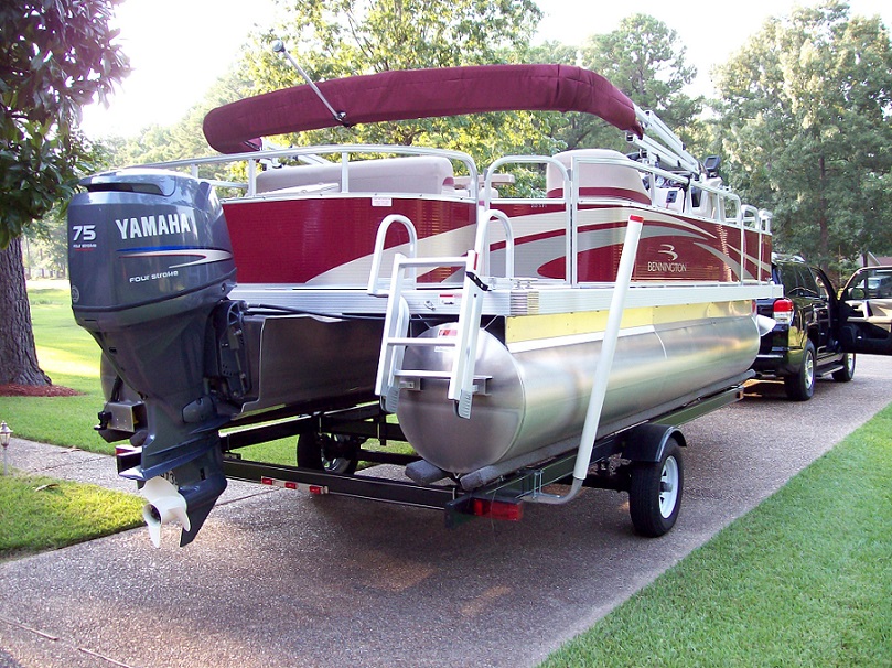

JNorris79... I had the exact same issue when I got my pontoon boat... I was so frustrated trying to load it on the trailer I was damn near ready to get rid of it... but then someone suggested I try these trailer guides. Since I put the guides on several years ago, I have only had one time where I didn't load the boat on the first try, and that was because of a stiff cross wind... when I'm coming in I just line up the right side of the boat to about 2 inches inside the right trailer guide... just an option to consider.

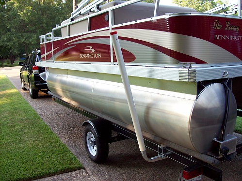

I made my own guides out of 2" PVC and it worked really well. My wife guides the boat on with ease and it only cost about $80 bucks total.

JNorris79- My boat is a tritoon as well. It works, I promise. I realize you don't see a center bunk on my trailer but that's they way I got it. You should be able to do the same anyway. It's actually doing the same job as the metal rails w/ wood bunks picture above it's just made out of PVC and uses stainless hose clamps to hold it to the trailer.

No sir, never had an issue with them being too wide... I suppose if a cop wanted to pull you over he could.. I asked a cop who was sitting at the launch one day if they were an issue and he said no... but here's the nice thing about them.. you can slide the white plastic pvc guides right off the bracket when towing and just put them back on when you're at the launch.. no tools or anything like that needed.. just slide one end over the bracket attached to the trailer and you're all done.
