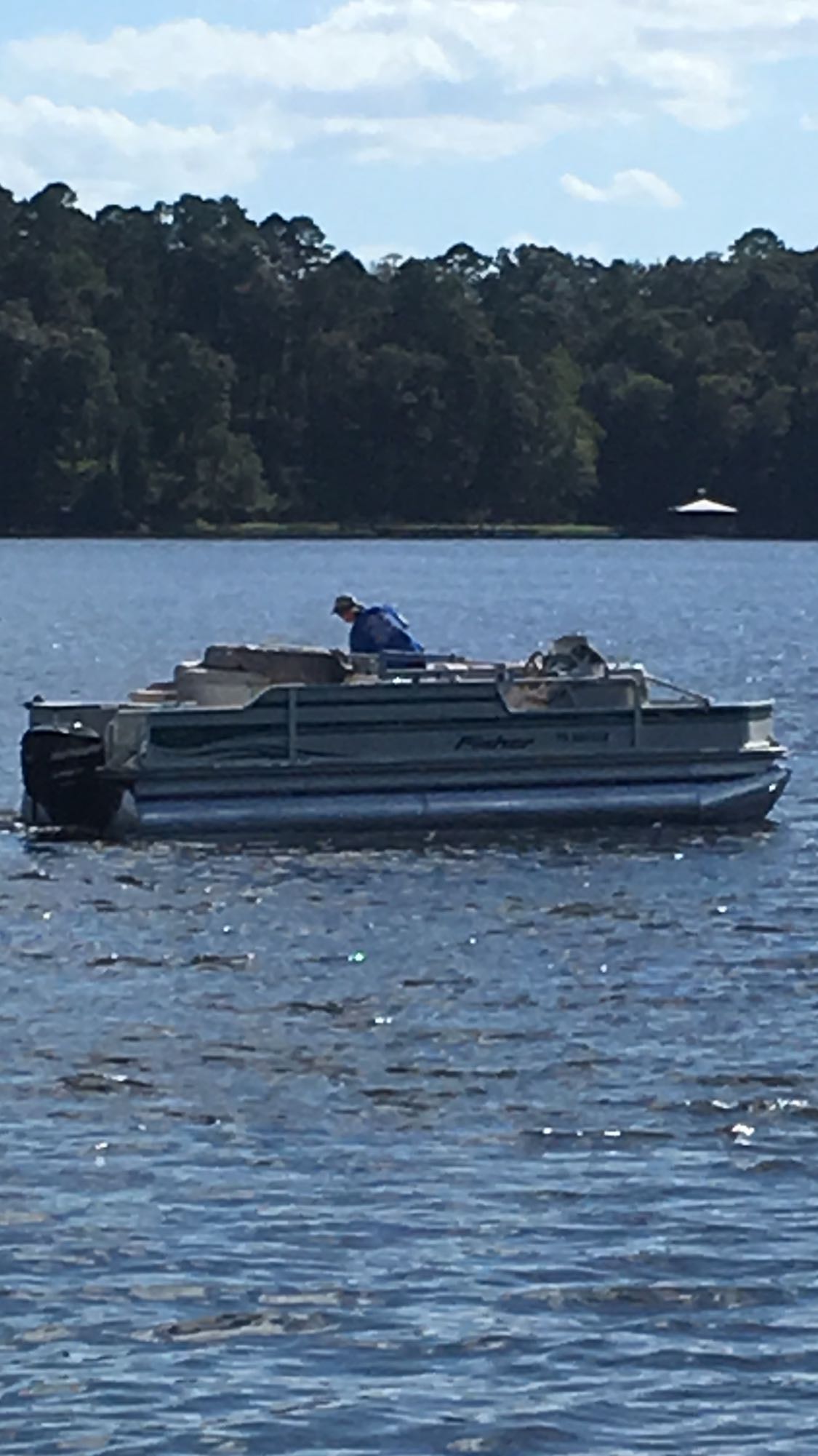

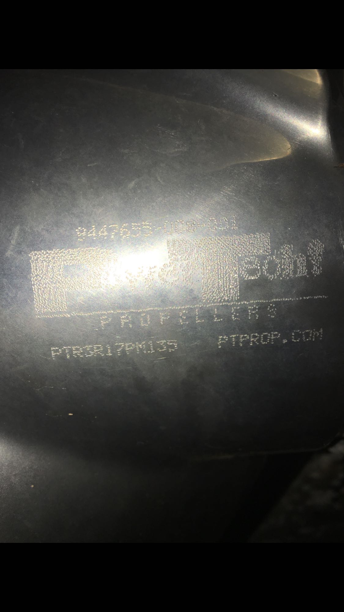

My boat is a 2003 Fisher 220 DLX/Fish with a 2010 Mercury 115Hp Optimax DFI with a 3 Blade Power Tech Stainless Prop PTR3R17PM.135.... I have never had a boat before other a small aluminum with a small motor so I am a green onion when it comes to setting Trim and exactly what that means. I read something about Trim In fully or Trim out. I adjusted trim playing around and I think I must have hit RevLimit as the power died, i shifted to neutral adjusted in and away I went again. It only happened the one time. The water was choppy and the wind was blowing today. Max speed was 18mph(trim all in) and we had 4 adults on the boat. I kind of felt like it would be a bit faster. Should I trim up some?
The motor should be in great shape as I just bought the boat for 4,500.00 and before I would agree we had boat mechanic check the engine out. 2,289 later out of the sellers pocket they told me the motor was running great.

2003 Fisher Freedom DLX 220 22 Feet on 26 inch pontoons
2010 Mercury 115HP Optimax DFI
13.5 Diameter 13 pitch Propeller
2.07:1 Gear Ratio
2180 weight
WOT RPM - 5,200 - 5500

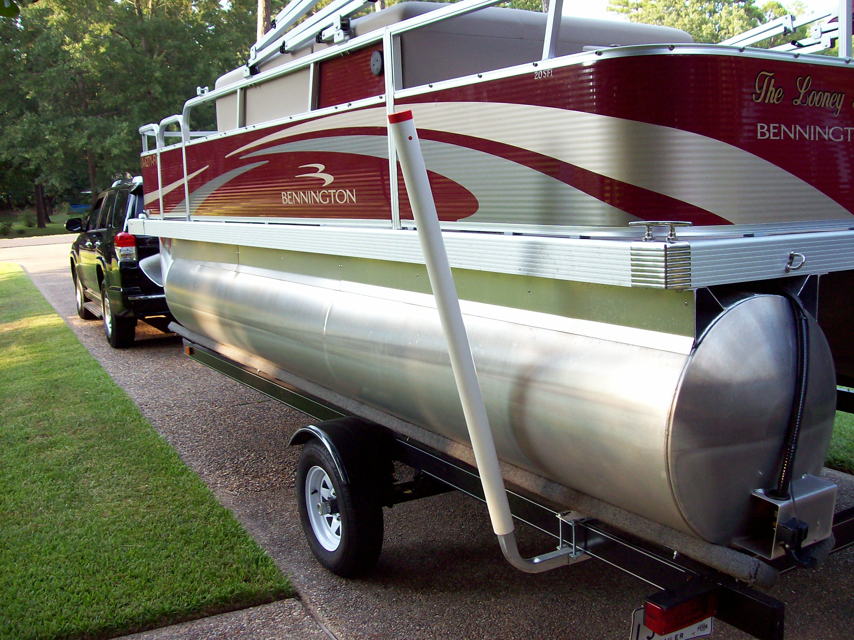

Thanks Guys for the information. I will try watching the RPM at wot and trim adjusting next weekend. I installed some DIY guides for the trailer but I think I need to go bigger. I used 3/4 pvc for flexibility but they were too flexible and didnt guide me as I had hoped. Truth be told I ran over one lol. I am going to try a bigger piece like the ones you have Roland.

What is your RPM with the throttle wide open, before it "blows out" and sucks air? Your prop is 13.5" diameter with a 17 pitch.

Those PVC tubes are not DIY in the sense of being only plastic plumbing-suppiy articles. They are sold as kits with internal metal bracing to reduce that flexing, available on-line/Amazon or at Academy, etc.Bruenar wrote: ↑Mon Sep 23, 2019 5:11 amThanks Guys for the information. I will try watching the RPM at wot and trim adjusting next weekend. I installed some DIY guides for the trailer but I think I need to go bigger. I used 3/4 pvc for flexibility but they were too flexible and didnt guide me as I had hoped. Truth be told I ran over one lol. I am going to try a bigger piece like the ones you have Roland.

I'm no prop guy but I've NEVER seen a 17 pitch on something as small as a 115hp. Most are in the 13-14 range and should be able to run upper 20's.

Steiner is right. That probably not the right prop. As a comparison, I have a PowerTech prop, too. My motor is a Yamaha 150 HP and I went from a 16 pitch to a 15 pitch because the 16 wouldn't let me get enough RPM at WOT. You want to be somewhere between about 5800 and 6000 RPM at WOT.
Re: Motor setup and expectations
Looked up some performance tests and looks like that's a prop they'd run on a smaller console boat or other weighing about 1000lbs less dry weight or 1500lbs less test weight than your pontoon.
Yep, I agree. That's why I looked up his prop and asked for RPM. Wide open RPM will tell us a lot.
