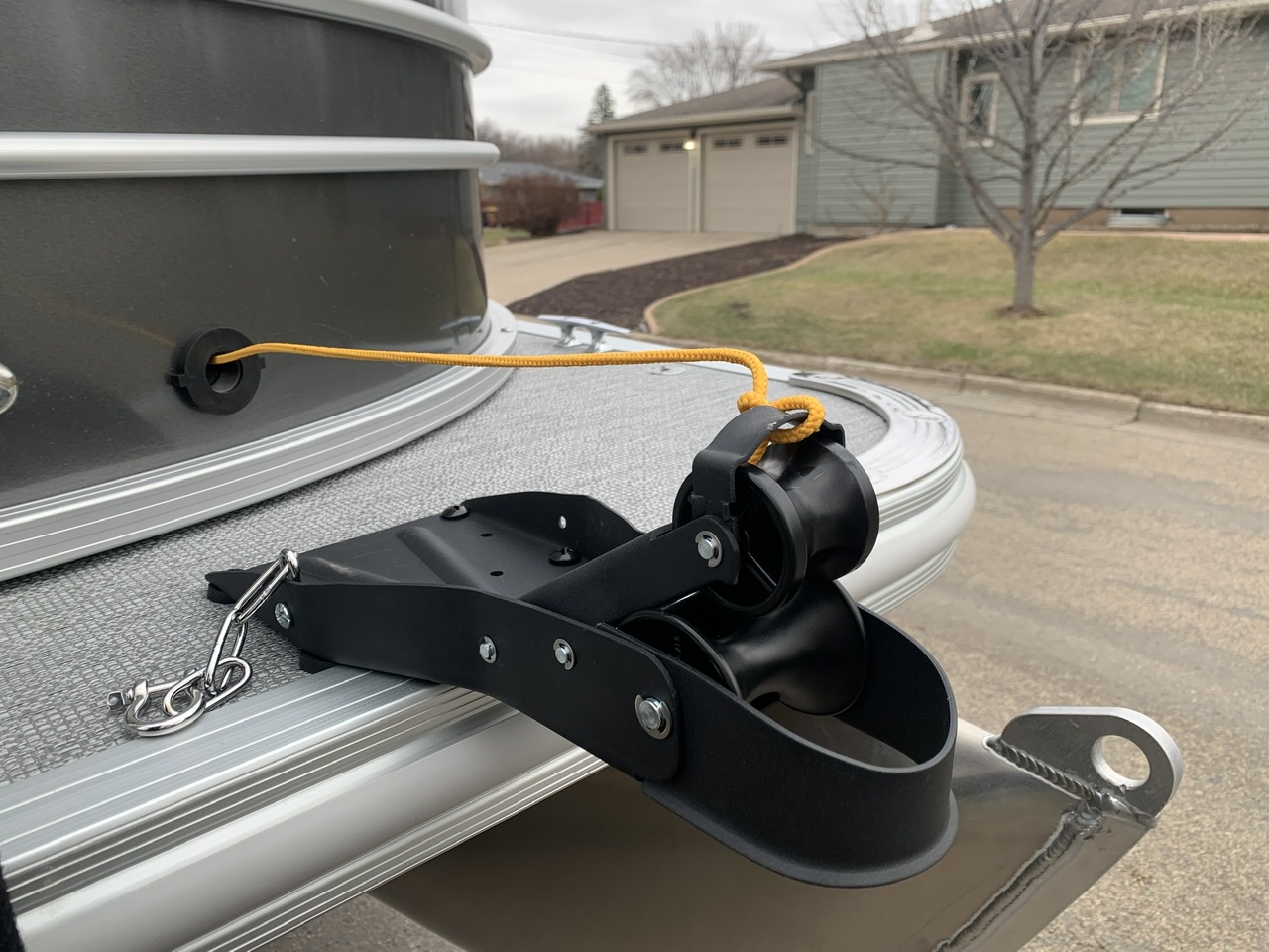

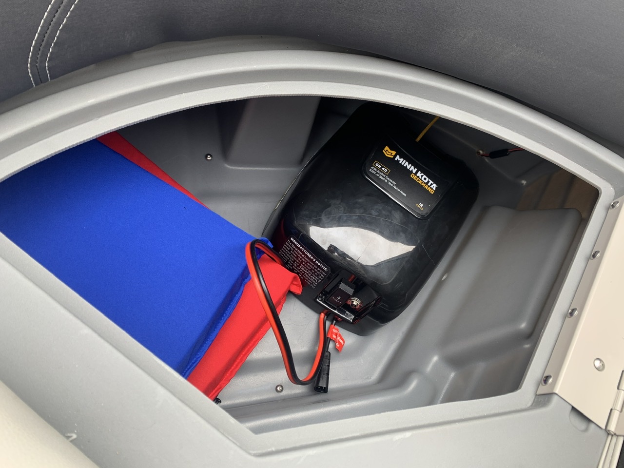

Alright so I got my Minkota 40 installed.
After much consideration, I decided to do it this way for simplicity, eventually might get a quick detach for it because it WILL be a pita to restring.
The short wires that go to the electronics under the shroud made it rough to get back together in the little hole, then I just eyeballed where I want the rope to go, and bore’d it out with a hole saw after pilot drilling.
This way the anchor doesn’t look so out of place out front, and is still accessible to put the safety chain on. (The main reason I abandoned under-deck mount)
I still have to wire it in, but I want to put a little bigger wire and save a spot to power an inverter for cell phones, tube inflator, and whatever other 110ac components that might fly my way. Would also like to cut a vent hole with a small fan to lightly ventilate the space under the seats but I have no idea if it’s really necessary, just thought it might be a good idea when storing for winter or keeping everything dry.

That's a very interesting and unique install. Was the through-fence, under-seat install due to the lack of front deck space for the actual unit itself? I'm very interested to see how it works out for you. Good on you for coming up with a solution to your issue!
Re: MinnKota Deckhand Anchor Winch?
Precisely. And I didn’t want to tie up a corner in the event a person wants to stand on the corner and fish.
This way the winch is protected and will stay dry, never get rained on ect.
