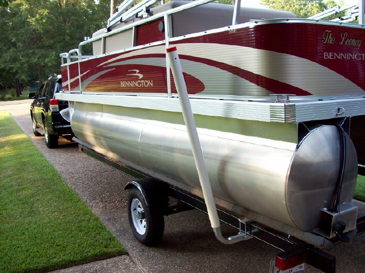

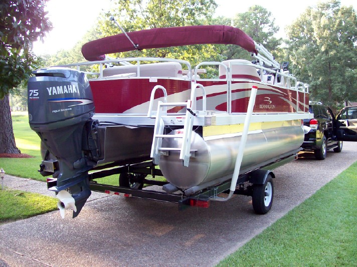

Ok boys & girls, you've all heard me belly ache about worrying when it came time to put the boat on the trailer... well, I just put on a new set of trailer guides this weekend and wondered if it would really make any difference loading at the launch..... I don't know if I just had a great day or these things really helped but if today was any indication, I love these things.... My son backed the trailer down further than I thought he should but he thought that now that I had the trailer guides on, he thought he could back down further, allowing me to float further in to the trailer, and that the trailer guides would keep the toons from floating off to one side or the other... whatever the reason, first time to load with the guides and it was a piece of cake. I was able to float quite a bit further into the trailer, which meant less "power loading" to get the boat up to the stop bunks... just lucky or trailer guides work? Guess the next 2 or 3 times out will tell for sure, but today was a pleasant surprise regardless.

How wide does that make your trailer, overall ? I would be worried about tearing those off in some of the places I go.

Looks like a good idea. I do not know if they would go over with Texas Highway patrol.
Looks like it would be a hazard going down highway. May be too wide. Would be great if you lived real close to lake. Glad you like them. Have fun!

I too would be worried about how wide they sit. I wonder if a guy could bend the tube they are attached to the trailer with, at a 90* angle. That would help a bunch as far as width. Those things look at about a 75* angle.

Gotta tell you when we first put them on I was concerned about the way they stick out to the side as well.. but after having the trailer out on the road just one time, I didn't run into any issues. As you can tell by the pictures above, that's a single car drive ( less width than a highway or road lane ) and they don't stick out past my driveway. I suppose you could try bending them, but be warned these are pretty heavy duty, plus there are companies that make basically the same thing where the posts are straight up and down. But I think the brackets that bolt to your trailer have to stick out further from the trailer frame to allow for the post to be straight up and down. I've seen both types at boat launches... probably 3 out every four I see are like the one's on my trailer. LIke I said, there not an issue when towing.

I know you already have them on, and you love them, but you have a VERY nice new clean boat. I have to tell you, those will scratch the sides of your toons if you keep them on there. I tried the kind you have, and with a little wind at the dock you will start rubbing on them going on and off the trailer. I purchased the ones that go on the inside of the tubes (see photo and link) I got a set of four and they make it so easy without sticking out so far, and without scratching your toons. The reason I had to sand and polish my tubes was because I had sharkhyde on them, then those PVC guide ons scraped the and scratched the tubes, causing the metal to go grey and foul the scratches, leaving big ugly dark grey lines down the sides of my toons.
Like I said, you have a VERY nice looking boat, and these would help keep it that way. They work great I promise.

Texaspontoon, gotta tell you, never even thought about the tubes rubbing up against the guides... I would imagine in a cross wind ( or me just being too far to one side or the other when loading ) that could be an issue. And thanks for giving me something else to worry about..texaspontoon wrote:I know you already have them on, and you love them, but you have a VERY nice new clean boat. I have to tell you, those will scratch the sides of your toons if you keep them on there. I tried the kind you have, and with a little wind at the dock you will start rubbing on them going on and off the trailer. I purchased the ones that go on the inside of the tubes (see photo and link) I got a set of four and they make it so easy without sticking out so far, and without scratching your toons. The reason I had to sand and polish my tubes was because I had sharkhyde on them, then those PVC guide ons scraped the and scratched the tubes, causing the metal to go grey and foul the scratches, leaving big ugly dark grey lines down the sides of my toons.

I have the same tall pvc guides on the outside but they were bent on a 90 degree angle and two shorter ones on the inside. The pvc pipes are loose on the metal brackets so they roll when the log rubs against them and not scratch the logs. When you lock the front of the pontoons between the four of them you will not drift and miss the bunks.

The pvc guides on my boat are tight... had to spray the inside of the tubing with a synthetic lubricant and then had to use a rubber mallet to drive the pvc guides down over the metal,so they sure don't spin free. Now I'm searching the net for some good foam covers to install over the guides to protect the boat and the toons... anyone know where I can get a good set of 48" guide covers, please let me know...margaritaman wrote:I have the same tall pvc guides on the outside but they were bent on a 90 degree angle and two shorter ones on the inside. The pvc pipes are loose on the metal brackets so they roll when the log rubs against them and not scratch the logs. When you lock the front of the pontoons between the four of them you will not drift and miss the bunks.
