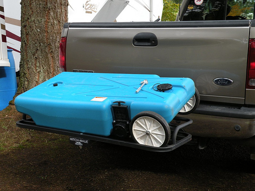

I think there is quite a bit of responsibility involved to at least attempt to protect water resources - regardless of whether or not you are allowed to dump gray water. The old camping axiom of "leave nothing behind but foot prints" is easily adapted to "leave nothing behind but a wake" when boating. It's simply the right thing to do.
I plan on carrying a "Blue Boy" 32 gallon tank under my trailer when my "trailer on a toon" project is done - just like I currently do when land camping. It has wheels and even when full is relatively easy to roll. A cup of 50% bleach and 50% water goes into it when I hook it up to keep any organic reactions from starting up - even when it's warm.
I'll definitely route all kitchen waste water into it and dump it appropriately along with black water when full. If you're miserly with water use that is a couple of weeks of washing dishes, brushing teeth, etc. for two people. We always wipe plates, pans etc. with paper towels prior to washing to remove debris. I can completely clean up the kitchen with a CUP of hot water and a couple of drops of Dawn or Lemon Joy. Both detergents are far superior to bargain brands when it comes to grease cutting and rinsing clean.
Shower water is another issue. As long as you are using a fully biodegradable "marine" soap with no phosphates I see no difference between that and taking a swim. Soap with phosphates is bad ju-ju since algae thrive on it, but it is increasingly be taken out of consumer products completely.
Dumping any gray water - or taking a shower and dumping - in a beach side mooring or marina is totally unacceptable and really bad manners.
blue boy.jpg (105.96 KiB) Viewed 6869 times

RonKMiller wrote:I think there is quite a bit of responsibility involved to at least attempt to protect water resources - regardless of whether or not you are allowed to dump gray water. The old camping axiom of "leave nothing behind but foot prints" is easily adapted to "leave nothing behind but a wake" when boating. It's simply the right thing to do.
Ron, you're also technically right and raise some very good points and hopefully your boating area allows enough conveniences that you can follow your sound environmental advise here. In the area I boat in it would be quite difficult and a hardship to say the least. I'd have to leave my general boating area and travel through two locks and an additional twenty miles to arrive at the nearest approved pump-out station to empty it. Is the carbon footprint involved or justified to avoid what amounts to maybe an ounce or two of soap into the river???
Now mind you we do deal with the porta-potty in the proper fashion by carrying and dumping it into available public facilities such as porta-johns located at various locations available in our boating area. Dealing with it is no big problem it's about forty pounds full vrs. your tank approaching three hundred pounds full.
