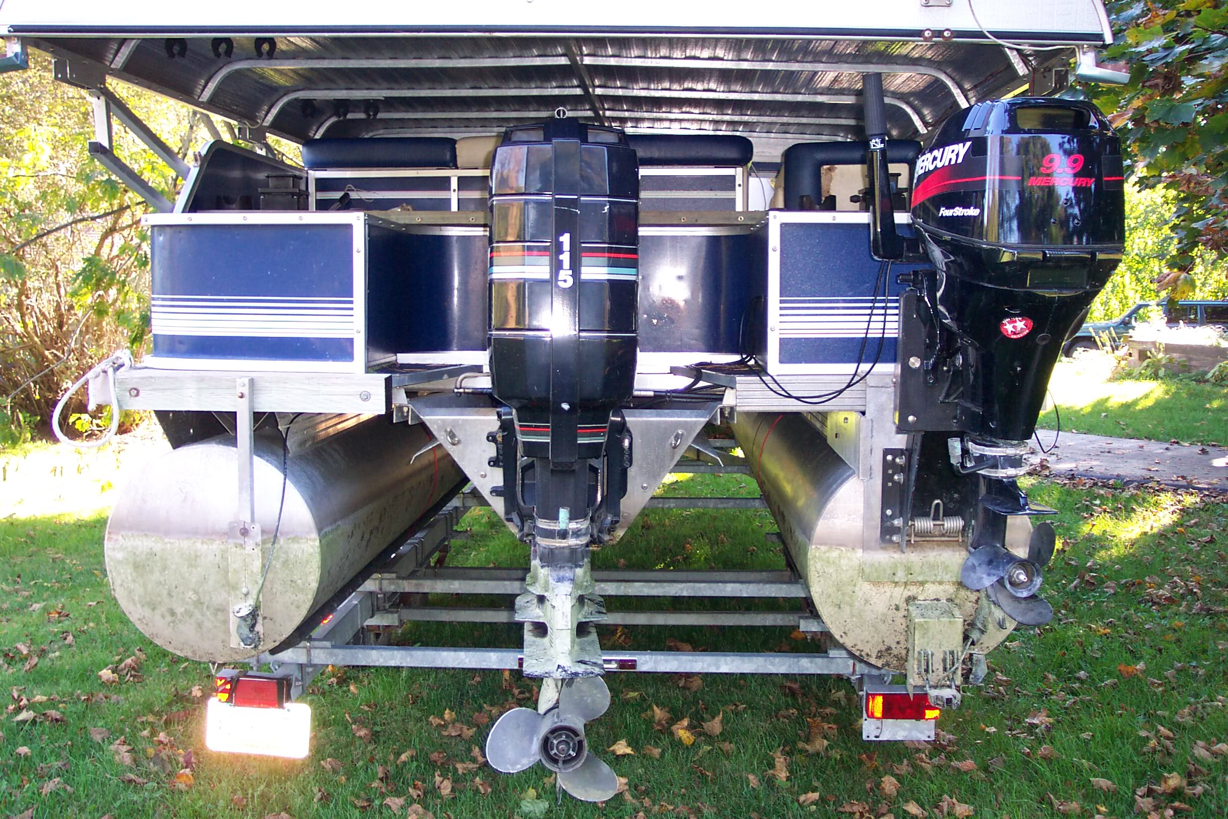

Re: Need ideas for mounting a kicker motor to my tri toon
Found this idea for a bracket. May require some fancy welding but it looks like the best way.
greezzmunkei wrote:Found this idea for a bracket. May require some fancy welding but it looks like the best way.
That was in the link/ picture I sent you. All you had to do was to click on the picture in the post. He has two different pictures on that post.
Look at both of them. They are small in the post though. I thought they were very good shots. Notice the two motors are linked together so
he can control either one from the helm. I don't know how he would start the kicker motor though, probably a separate starter switch. He
urely wouldn't start it with the pull rope after spending that much money to put it on the pontoon.
Chuck
I think this setup is going to work. I already have the control bar that links the two motors and the seperate throttle control I bought had an igniton switch on it and had the provisions for it in the wiring harness. I'll be basing my design on the picture above, but instead of aluminum, i'm going to fab mine out of high end Stainless partly because of strength partly because i'm already set up for TIG and not heli-arc. Before I mount it i'll take pictures and post them. thanks for the ideas all.
