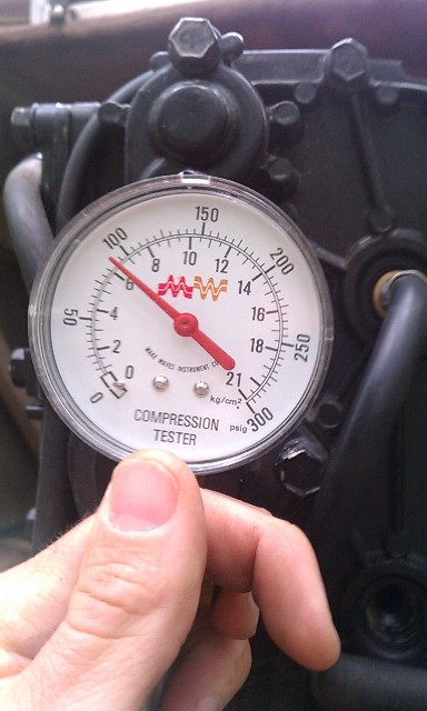

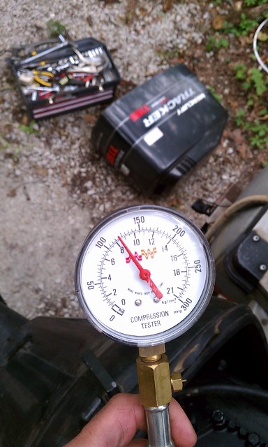

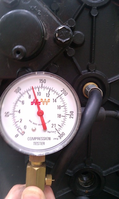

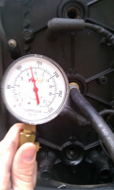

Well here are the pics of my compression and a video of it running the knock sounds a lot worse in person.
Remember this is a 17 year old motor still with 125 lbs. Damn I wish they all had it.
I stopped at PJ's Marine outside of Clinton and he quoted me 800 at the worst if it was the connecting rod and not just rings. So for 600 - 800 hundred back in business, with vacation coming up it may be sittin for awhile.

- Number four
- IMAG0294.jpg (48.4 KiB) Viewed 2410 times
- number three
- IMAG0295.jpg (47.39 KiB) Viewed 2410 times
- Number two
- IMAG0296.jpg (53.99 KiB) Viewed 2410 times
- number one dry
- IMAG0299.jpg (59.27 KiB) Viewed 2410 times
- Number one wet.
- IMAG0300.jpg (70.39 KiB) Viewed 2410 times
