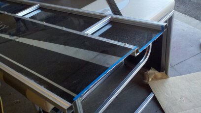

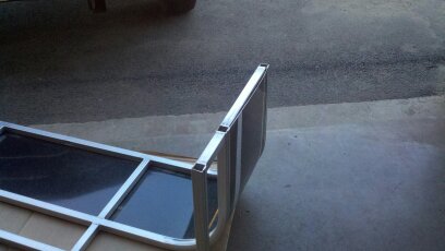

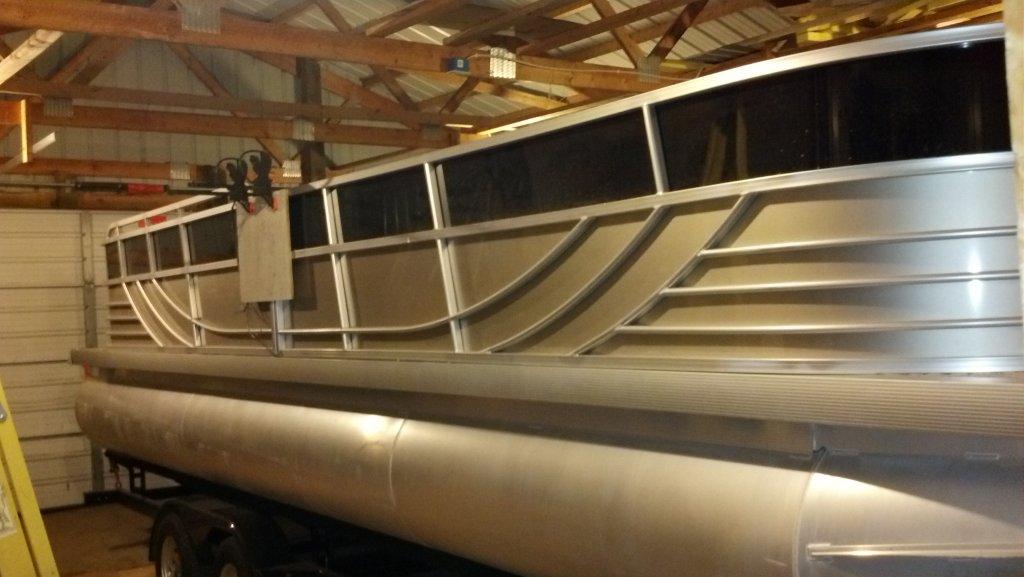

Still working on the South Bay build. Nice new railings with the South Bay sweeping braces.
Of course, when docking, my crew can tend to the front corners outside the playpen, but I much prefer the safety of general loading/unloading of generally loaded people out the side doors of my soon-to-be-ex boat.

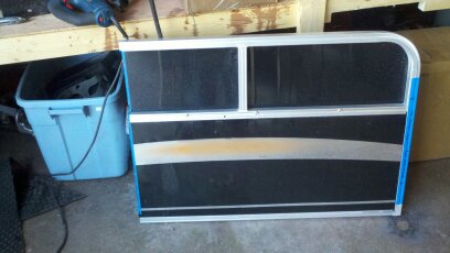

I am hoping to cut doors directly into both railings, as I would never get a custom door to match. Has anybody done this before? I would have to peel back enough skin (or not) to weld in some vertical railing tube in order to make the door. Some careful cutting on my part, then find a good mig/tig guy. Finally fix the skin as best I can.
Can I perhaps leave the skin in place while doing this? Or will it seriously discolor from the heat. Skin repair otions can range from epoxy, to rivets, to ordering more South Bay skin in the right colors and scab repairing it?
I cerainly could use some input on this touchy one. I would hate to bung it up at this point.
As you can see there is no Starboard side door. The Port door is in the wrong place as well because of the wheelhouse that I will be putting on.Of course, when docking, my crew can tend to the front corners outside the playpen, but I much prefer the safety of general loading/unloading of generally loaded people out the side doors of my soon-to-be-ex boat.

I'd contact toonguy again, see if he has any spare doors that he could sell you, just to get the frames and top curvature.
As far as the side panels go they can't be anywhere near the welding sparks, either remove the panel, peal it back, or get some welding paper or blankets to cover them (remove is best but most time consuming, but it will give you more space to work when you start trimming the panels for the new doors
If you get lucky and can get whole doors, you will still have to make new frames and transfer over the arching braces. Two side doors would be awesome, but a little more work because you might have cut out the old arches
Just thoughts.

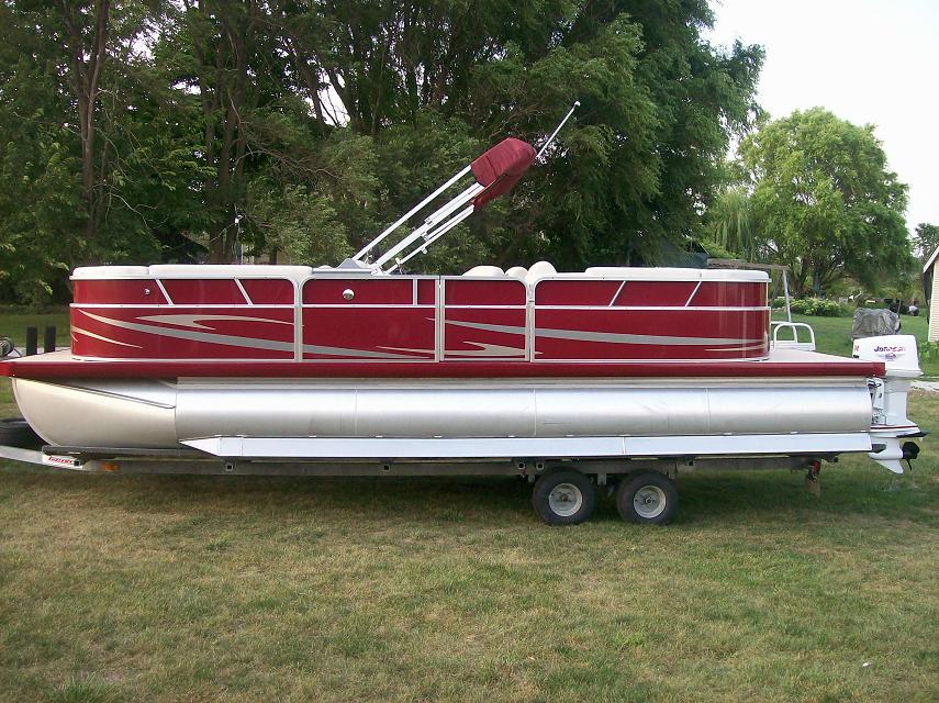

That, Sir, is BEAUTIFUL. I love that kind of Bauhaus look. It looks like something out of a 40's era sci-fi book.tuned wrote:Still working on the South Bay build. Nice new railings with the South Bay sweeping braces.

Thanks Ron. I am hoping to not buy anything further (unless I need to repair/replace skin). Just do straight vertical cuts on the existing rails and weld in four new uprights, two for the rail and two for the door. The back edge of the door would start about at the post where the arches sweep up. Square doors will look fine as long as all the braces/arches line up.ronb wrote: I'd contact toonguy again, see if he has any spare doors that he could sell you, just to get the frames and top curvature.
-ron
Do you (or anyone else) know how this skin is attached? I haven't had time to look real seriously at it yet. Just digging for info.
I was just researching and it appears as if gas micro welding may be prefered over mig for something this small and delicate. Any thoughts all you welders?
